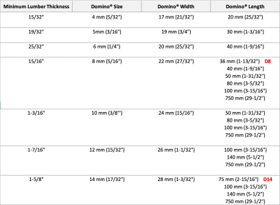

Is there a cheat sheet somewhere with all the info?!

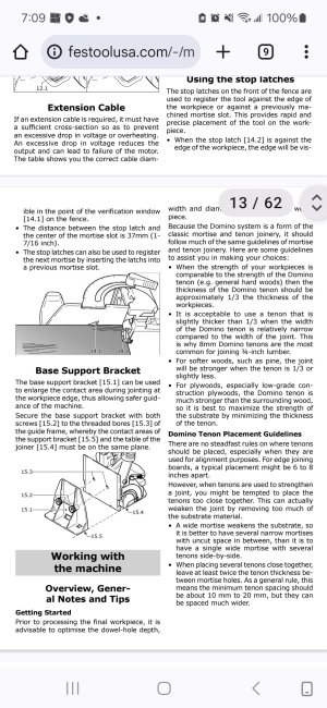

You can find answers to your questions on p. 13 of the user manual.

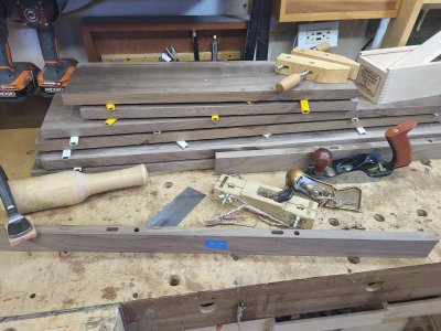

As luvmytoolz suggested, get the tenon and cutter sets so you can make full use of the machine. I've used the full ramges of sizes of tenons for my projects. 4mm, 6mm and 8mm (for 3/4" hardwood as shown in the second pic) dominoes are mostly used, and so I buy them in bulk packages to save money.

The chart is quite handy, but the wood species (softwood vs hardwood) and joinery strength can affect the final choice. I've used 4mm on 5mm ply and the project stands the test of time.

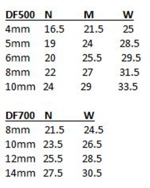

@ChuckM I make my own tenons using the special reeded cutters, but only specifically for the DF500 6mm/8mm/10mm cutters on the widest setting as there's such a good increase in width. I wish the DF700 also had a wider setting as there's only 3mm difference in slot width..
Oh, I, too, made my own 10mm tenons that were about 120mm long for one chair project. For those mortises, I made them deeper with a drill kit.
I use the DF700 for anything longer, but I love that I can use 33.5mm wide tenons for the 10mm cutter on the DF500, comes in really handy for a lot of projects.
