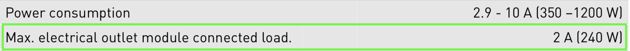

Hey everyone,
Perhaps dumb question, but I just picked up a CT15 dust extractor (first Festool vac!) and am loving the auto-on tool outlet with my sander. I saw in the instruction manual that it says "Max. electrical outlet module connected load - 2 A (240 W)". I assume this means it can't be used with tools that draw more than 2 amps? My Makita track saw has a 12 amp motor according to it's manual. I'd be quite disappointed if I can't use the auto-on feature with that, but don't want to try it if it's going to fry my new vacuum.
Any thoughts? I thought these vacs were commonly used with track saws. Thanks in advance for any guidance!

Thank you for the reply. That's what I thought, too. But then I noticed different specs are listed in the MIDI and CT15 manuals (this is straight from Festool's current website):
MIDI/MINI:
CT15:
So just wanted to be overly cautious. I keep hearing people say "I'll use CT15 as a dedicated Kapex vac" etc and was confused why it's listed so low. It also says this under connecting a power tool:
Makita lists the saw at 1800W, which greatly exceeds even the MIDI warning, but I guess if it works it works?
MIDI/MINI:
... snip ...
Careful here.
That is clearly the old international manual as it includes no voltage and only wattage values. The problem is the wattages are for the European (230V) vacs which are 3600W (16A) total with 1200W (6A@230) for the vac and 2400W (10A@230) for the tool.
At 120V that would require a 20A socket (!) on the tool and attendant thick cabling with a 30A wall plug. I am sure you would notice that..
It is also a manual for the OLD generation of the Mini/Midi. It does NOT apply to the current generation Mini/Midi HEPA units nor to the US-sold units with 110/120V motors!
Of course, with a light-duty-cycle tool, especially a power-limited one, it will work well beyond sustained load spec. But these specs in the old manual are no 110/120V specs. Far from them.
Fair point. I am operating off 230V.

Thanks for all the info. The screenshots I took are from what's currently on Festool USA's website. It did not differentiate between generations of MIDI, just one link. If they are giving Euro specs for last gen vacs on the USA website, then that should probably be updated...
For what it's worth, the paper manual my CT15 came with lists the same 2 A (240 W) information.
And there is a sticker right on the receptacle cover that says this:
I'm in the U.S., purchased from U.S. distributor (Tool Nut), and the receptacle is a U.S. receptacle.
I am going to contact Festool and see what they say. If there is anyone in the U.S. using the CT15 on 110/120v with a higher amperage tool (like 10-13 amps), and has had no issues anecdotally, I'd still appreciate hearing that out of curiosity.
