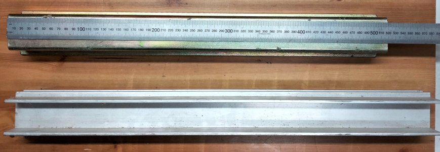

First Glance:
I'll go into more detail on each aspect of the clamps later, but at first glance It's really hard to appreciate just how large, rugged and well designed these clamps are from online pics or videos. Holding them up close however it becomes very apparent that every part has not only been beautifully machined, but also really well designed. It's not until you use them that you appreciate the level of thought and engineering that went into them. The rails measure 80mm high x 75mm wide, and are exceptionally well made and due to the profile, provide a level of rigidity that is astounding.
Con sells clamps in standard sizes of 900mm, 1200, and 1500mm (and longer ones used industrially mainly), in a standard height, and an extended height. The difference between the two is the height of the assemblies. My 1200mm clamp set is 1450mm long overall, and I actually get around 1230mm max clamping width, so it will easily accommodate standard 4' (Imperial) size panels. The handle is Chrome Vanadium steel, and makes winding the leadscrew an effortless task. The 1200mm clamp sets are each a touch under 13Kg, and with the substantial size of the rail profile, sit nice and firmly on whatever surface they're on.
Looking at the end on comparison pics below, the left two clamps are both standard height sets, in low and high mode, the two on the right are extended height clamp sets, also in low and high mode. You can see how the assembly slides into the upper or lower channel to use the low or high mode. The solid locking pins (12mm x 85mm hardened steel) have a spring loaded ball bearing to retain them, and are easily popped in/out of the rails to change the clamping width or height as required.

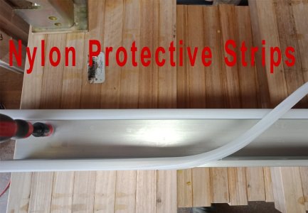

You can also get nylon protective strips which makes cleaning up really easy. These strips are purpose designed for this profile, and are a very strong, and firm material, getting them onto the rails can be a tricky affair, but is made far easier by simply clamping one end of the rail down to a bench or table to allow you some leverage.

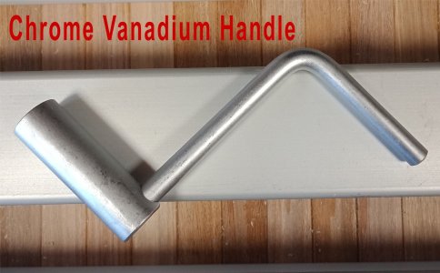

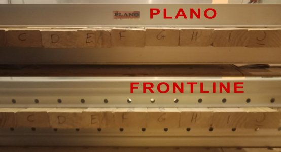

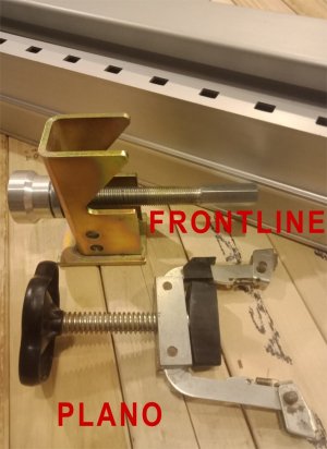

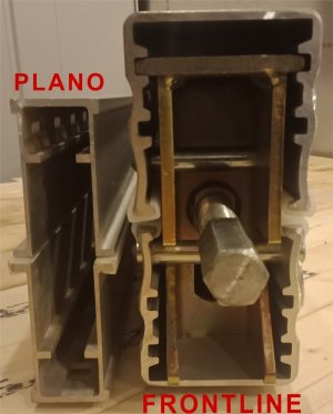

Plano / Frontline Comparison:
I don't want to turn this into a turf war or be too negative, and again this is purely based on my own opinions and experience with these clamps, so I won't dwell too much here, especially as I think the attached photos tell the story pretty well!
But what prompted me to finally write this review is in part because of queries/comments over the years regarding Frontline, a true 4 way clamp, and other clamps that claim to be a 4 way clamp, occasionally with references from people who have never seen a Frontline clamp in the wild, let alone held one, make direct comparisons to Plano clamps, homemade bar clamps, and even the Veritas style bar clamp kits, often asserting "no difference bar cost"!
Comparing any of these to a Frontline clamp is like comparing a dowelling jig to a Festool Domino, there just is no comparison and they are NOT like for like!
Out of the very small amount of alternate panel style clamps on the market, Plano is pretty much the only other real commonly available contender to a Frontline style clamp, but in my opinion, after having bought and used them myself, the build quality, performance, and usability simply do not compare to Frontline clamps. As mentioned earlier, in use I found them far too flimsy and finicky, with sub-par results, and I absolutely hated the fiddly mechanisms. I'm sure they have a welcome place and prove useful for many Plano owners and that's great, but they didn't work out that way for me unfortunately.
At the very least though no matter how popular they may be for some, I'm sure most people would agree they are just ridiculously priced given the performance, parts design and build quality, especially given how much more expensive they are in Australia. I know I certainly felt more than a bit ripped off after using them.
The timber seen clamped has simply been placed and clamped, no mallet use or board alignment performed on either clamp set. The thickness did vary slightly with a few boards, 90 x 45 Pine framing being what it is. The Plano clamp set shown (900mm) weighs 3.76Kg total, with a third of the weight (1.225Kg) in the steel mechanisms, so calculating the weight of the aluminium rails (2.535Kg) will make a 1200mm set around 4.45Kg all up including the mechanisms.
The Frontline 1200mm clamp sets weigh in at 12.75Kg for the Standard Height (older design) clamps, and 12.8Kg for the Extended Height (newer design) clamps. The newer assemblies have reduced the weight quite a bit, whilst remaining as strong, if not even stronger due to the enhanced shape.

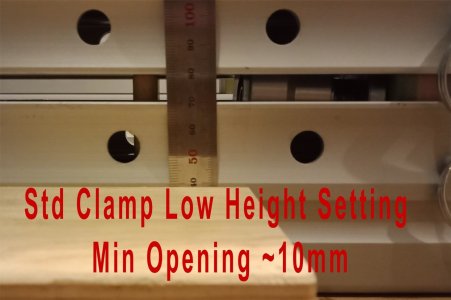

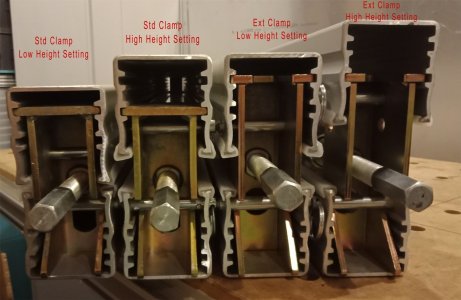

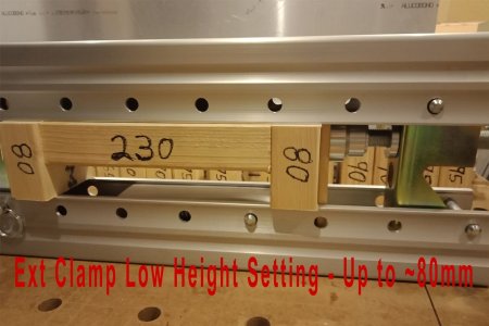

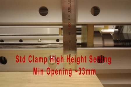

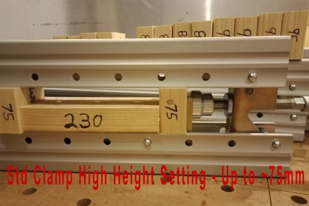

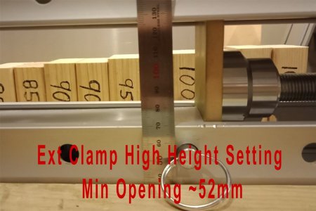

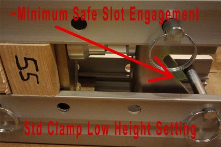

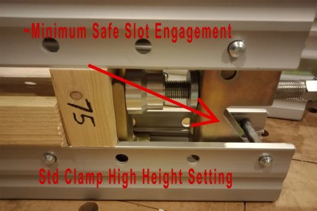

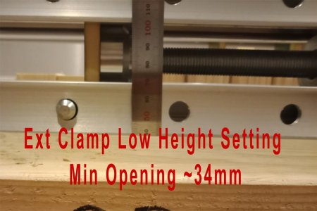

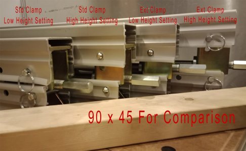

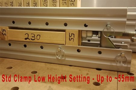

Minimum and Maximum Clamping Ranges for the Standard and Extended Height Clamps:
The attached pics show one of each of the Standard Height clamps and Extended Height clamps each in a Low and a High height mode, so 8 pics total. To change the height to be clamped simply involves sliding the metal End Stop and Thrust Bearing assemblies into the upper or lower channel in the rails, suitable for the thickness you want to clamp. The spring loaded assembly stays put.
I've also included pics of two variants showing the pin engagement on the assemblies, as sometimes I tend to push the clamping range to the max, while still maintaining a safe clamping setup so I can squeeze that extra bit of thickness out. As the clamps are forced in opposite directions pulling them against the locking pins, and my clamps in use are invariably out of the way either standing against a wall, or laying on a frame or table, consequently I've never been concerned about the prospect of them coming apart (never had one come apart yet) if it was hit by something sufficiently big/heavy enough. If you were really concerned about running too close to the wind though, you could probably shave 1.5-2mm off the max height to give a larger margin of safety, or whatever you're comfortable with really. Again, it's a 45 degree slot on the assembly that engages the locking pin at each end, so the amount of force holding them in place is quite large.
The ranges as measured on my own clamps:
- Standard Height Clamp Set in Low Height Mode had a range of 10mm - 55mm
- Standard Height Clamp Set in High Height Mode had a range of 33mm - 75mm
- Extended Height Clamp Set in Low Height Mode had a range of 34mm - 80mm
- Extended Height Clamp Set in High Height Mode had a range of 52mm - 105mm
It's important to note though, if you're using the Nylon Protective Strips, you'll need to deduct exactly 4mm total off each of the Min and Max ranges. The strips add exactly 2mm to each clamp.
If you find the Min clamping range is too high for the material you want to clamp, you can simply use a packing strip of MDF or whatever, ideally wrapped in Gladwrap or foil (to not stick) under the timber to be clamped, this will work perfectly fine, and even allow you to successfully do materials as thin as veneers with ease (obviously with a board top/bottom for even all over pressure).

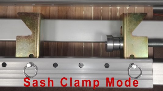

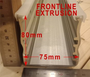

Sash Clamp Mode:

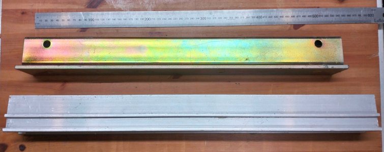

Each clamp set can also operate in a high or low sash clamp mode using either the end assembly or the spring assembly from the bottom rail, along with the thrust bearing assembly from the top rail as shown.
This is incredibly useful for quick and simple glue ups, and as the rail profile is so wide, it sits flat and stable, unlike the precarious nature of traditional sash clamps that always seem to want to flip on their side.

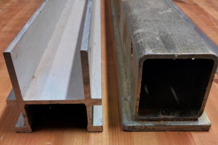

Another thing to note is the shape of the rail profile itself, this is no cheap tube or square walled rail like most cheap clamps are, these are maximised for rigidity, so that even in sash clamp mode, they will strongly resist any tendency to bow, unlike pipe/sash clamps which seem to have a mind of their own in use!

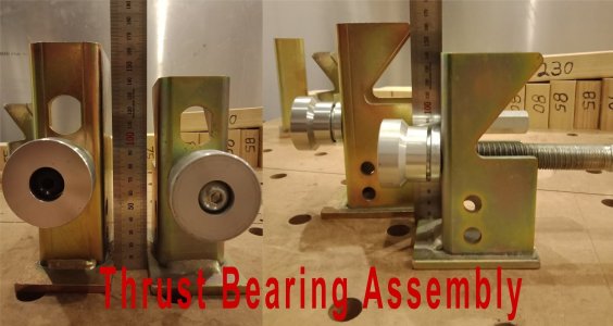

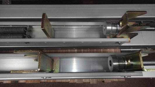

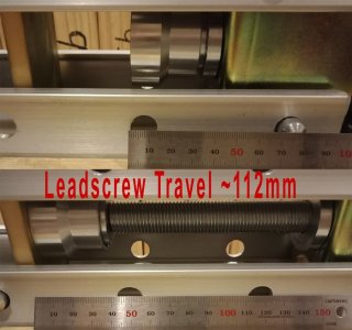

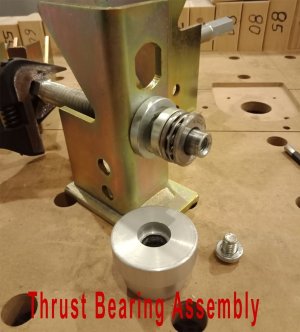

Thrust Bearing Assembly:
Out of all the well machined and designed components with these clamps, nothing screams quality and thoughtful engineering to me as much as these bearing assemblies, just feast your eyes on all those beautifully machined parts! A huge chunk of machined aluminium with a very large, good quality (German I believe) thrust bearing, so no matter how much it's tightened, you get no lift or shift of material whatsoever! Pretty amazing really, I certainly have never had clamps that thought of such a simple and obvious, but very crucial and helpful detail like that. And I don't think I've even seen others designed like that from my recollection.
I know from my CNC machine and spindles that good quality thrust bearings are quite expensive, so the manufacturing and material costs certainly couldn't be cheap for this assembly!
As you can seen by the attached pic, this assembly is a very sizable and impressive bit of kit, and can achieve an absolutely astounding amount of force when clamping. In fact it is pretty easy with not much effort at all to over tighten the clamp and end up really crushing the timber, which is why you would always want to have an offcut of timber between the panel to be glued and the clamp ends.
The leadscrew, 3/4" or M19 thread by the look, allows you to apply large amounts of force gradually and very smoothly, instead of the clunky, aggressive pitch on a lot of other clamps, and it can be moved into a lower or upper position on the assembly depending on how you're using the clamps, and the size of the timber. Generally though, unless you are using the clamp in sash clamp mode, you would probably never move it from the default position. Or maybe that's just me being lazy.
The leadscrew as mentioned prior does also allow a very generous ~112mm travel, which you may not think matters that much, but it is extremely useful in practice to not be bound by a small amount of travel with a clamp.
I've been using my set close to 25 years now, and must admit I probably tend to apply too much of a death grip, but my set has no detectable wear or issues of any kind, despite the staggering amount of use over the years. I have no doubt they'll well and truly outlast me!

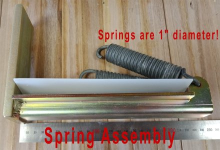

Spring Assembly (True 4-Way Clamping):
The two massive (1" diameter!) springs on these assemblies are what helps apply the clamping pressure across the face of the material, forcing the top and bottom clamps to slide in opposite directions using a simple yet absolutely ingenious, angled inter-locking mechanism, this exerts a tremendous amount of pressure on the faces which first aligns the boards dead flat, before any side pressure has even been applied! This is the meaning of a true 4-way clamp. Once the sides have been clamped, the whole assembly is dead flat, and straight, and the clamps can exert something along the lines of 4 ton pressure, so you can really apply a massive amount of force!
The clamps come supplied with a piece of polycarbonate that protects the assemblies from any glue drips.
If I can work out a way of measuring the actual force applied I'll do that down the track, but in use I've found the force is enough to flatten quite thick (~45mm), and somewhat twisted boards (as can be seen by the twisted 90 x 45 Pine framing in the pic comparing the Plano to the Frontline).
Obviously if they are overly twisted/cupped, etc, and depending on what type of timber it is, it might well be that nothing short of magic will automatically flatten them so they might need a few hits with a mallet. Boards that are quite bowed but glued together along the face, not the edges, will usually work out just fine. I've made a few work tops over the years for mates out of quite bowed and lightly twisted 90 x 45 Pine framing, and they have held up well I've been told despite the abuse given to them.
Thin boards (~8mm-13mm or so) no matter how bowed/twisted (within reason) seem to come together and stay that way pretty fine I've found, thicker boards (~19mm-30mm or so) if not too bowed/twisted generally work out just fine. Going thicker than that with ideally minimal twisting/bowing also tends to work out fine usually. Again, common sense applies, if you're gluing up boards that are that twisted and especially if it's a dense hardwood, you'll likely find that in use the timber will naturally (and sometimes quickly) fracture, or work the joins apart to find equilibrium anyway.
It's important to note, in order to let the springs do their job in flattening the panel faces before side pressure is applied, you need to leave some space, 2-3 inches is good, between the boards being glued up and the thrust bearing assembly, so the springs have room to extend, thus putting pressure on the clamp rails to ensure flatness of the panel. Again, very thoughtful design has ensured you have around 112mm travel, leaving plenty of room to spare! No bruised knuckles when clamping up!

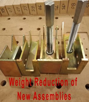

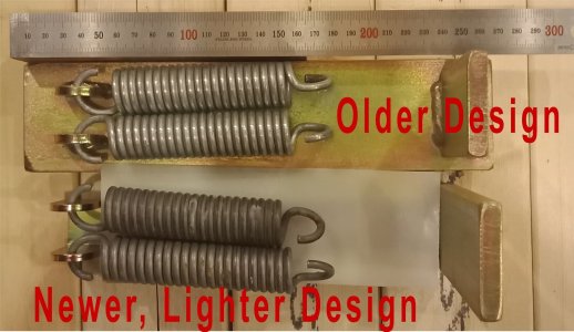

Design Improvements/Evolution:
Con hasn't been standing still with his original clamps design, and has been refining and improving certain aspects of them, although there's not really much that can be improved upon, he has managed to reduce the weight of the hardened steel assemblies with a new, and even stronger design. I won't detail all the differences here, but as an example, the (older design) Standard Height Spring Assembly at 270mm long x 142mm high weighs in at 1.675Kg while the (newer design) Extended Height Spring Assembly at 230mm long x 166mm high weighs in at only a fraction more at 1.72Kg, whilst further increasing the strength and rigidity of this component. Without the improvements to weight reduction, the Extended Height set I would have estimated to come in around the 14.5Kg mark all up based on the existing older design components in my set.
I believe he has also recently changed to a new stronger Aluminium alloy that has allowed him to reduce the weight while maintaining or increasing the overall strength. I'll try to find out more about that and update here at a later date.
The pneumatic piston clamps for these rails are also just amazing, and I'll endeavour to add a comprehensive review on them when I can. Although they really are more an industrial purpose tool.

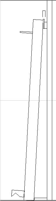

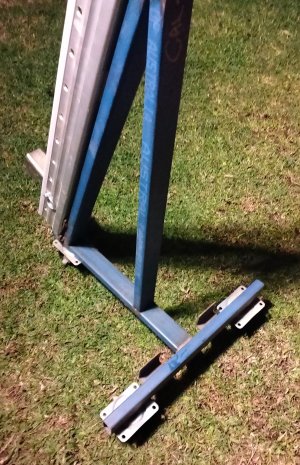

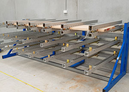

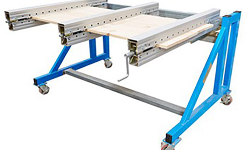

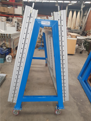

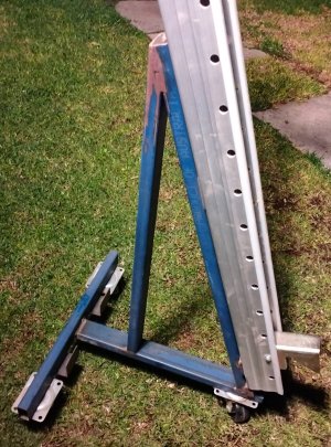

Mobile & Stationery Racks:
To allow more efficient use of space when clamping any size or quantity of panels, Con also has a range of custom racks in single and multi tiers, in horizontal and vertical inclines.
In my shed I use several of the small "A" frame mobile stands shown in the last 2 pics for smaller glue-ups, I find these are insanely useful being compact and mobile.
For longer panels I simply screwed a timber rail to the wall for the clamps to rest against held in place with a clip from the top, and a piece of framing on the floor to push the bottom of the clamps 4" out, so it's practically vertical but won't tip over, and takes up very little space in use. This simple but effective setup can be seen in the crudely rendered pic.

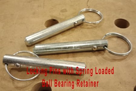

Putting spring loaded bearings in the pins is another indication of the thought that went into every aspect of these clamps, such a simple trivial little thing, but so incredibly practical and useful, you never need to worry about anything moving when you least want it too.
When I was using my old T type sash clamps many years back, the pins would fall out if you looked sideways at them, I was so glad when I got rid of them all.

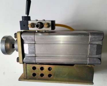

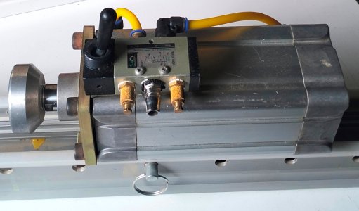

Pneumatic Piston Clamp:
Definitely a more industrial use component due to the expense, Con also supplies pneumatic piston clamps that work in the Frontline rails in sash clamp mode, to allow a more rapid workflow and help streamline processes.

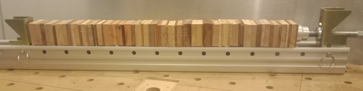

I do a very large amount of small wood blank glue-ups as can be seen in one of the earlier sash clamp pics, each piece measuring around 90mm x 90mm x 5-10mm thick, which is a very tedious affair to say the least. I need to apply glue to both faces, align them in the clamp, and tighten without them sliding around or making a hideous mess before they tack dry.
The pneumatic piston makes this a very trivial job for me now. It has a 90mm throw so I can glue a bunch at a time, put them in the rail, and clamp, no fuss or wasted effort. I first load up the rail with a number of a pieces of pine stud as packers to take up space, and remove one or two of them to insert a stack of blanks to clamp. I then assemble the next lot, remove another pine block or two, insert the blanks and clamp. This process is repeated until they're all done. I estimate it's halved my assembly time while greatly reducing the messiness factor.
For panel glue-ups with a lot of boards and especially when using Domino's, it saves a massive amount of time and effort, and stress, as you can use this in a centre panel clamp in sash mode, with normal panel clamps on the ready either side, and as you glue up each panel with the Domino's you can instantly clamp it with the pneumatic piston while getting the next one prepared, once they're all done, assemble the outer clamps and tighten the leadscrews.
The piston has a 90mm throw, and doesn't pull a great deal of air, I run it very happily off a small 30L air compressor, but the amount of clamping force is amazing, I'm not sure of the exact figure, but I recall it's around the 250-300kg mark.
As with the other components, it has a dual row of mounting holes, so it can be used in a low or high clamping mode to cater for different height timbers, in high mode you would be able to glue up very sizable objects easily.
The link in the second post near the top of this review for Stu's Shed also shows the piston clamp at around the 18:34 min mark in his review.
