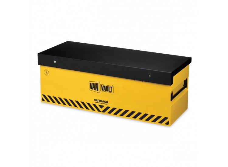

Dont know if you have them stateside but i use a vanvault outback. It fits 4 systainers wide and a sys 4 and sys 2 tall.
