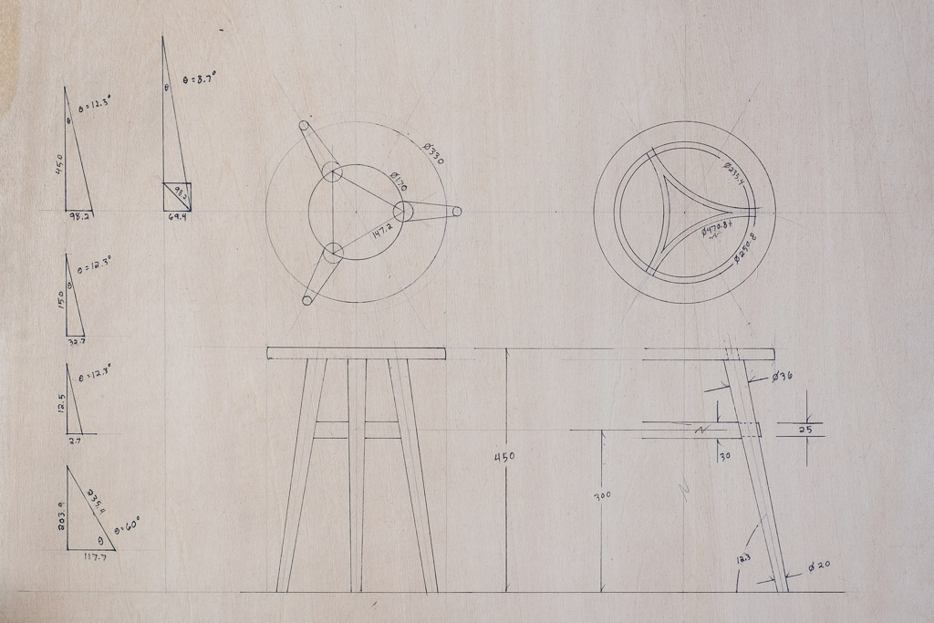

I'm starting a little side project to understand stakes better. I've taken a bunch of 33mm x 75mm cutoffs and glued them up into a roughly 12"x12" square.
The plan is to bore three round mortises to fit the legs. I'm thinking 20mm holes and I think they're supposed to be at 15 degree angles - does this sound correct?
Not too long ago, I sat in a stool made by a very experienced craftsman and I loved it. The seat angle forced me to sit properly with good posture. The maker told me he put a ten degree angle on the seat. I would like to recreate this seating position.
If I'm boring 15 degree holes and legs, what is a good way to achieve the ten degree angle (slope?) for the seat? Is it just a matter of increasing the rear-ish legs? Or do the bore angles need to change as well?
Thanks!

When I made my set of Tage Frid-inspired three-legged stools, I followed his instructions to the dot: 94* for the two front legs and 72* for the back leg. But his design includes a chair back.
