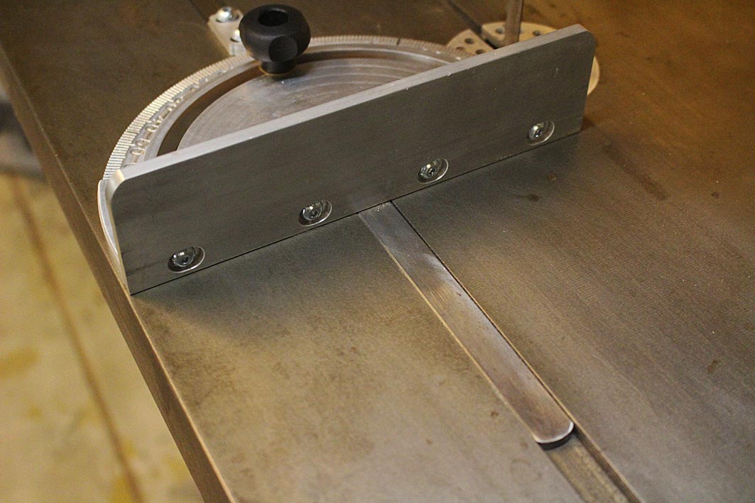

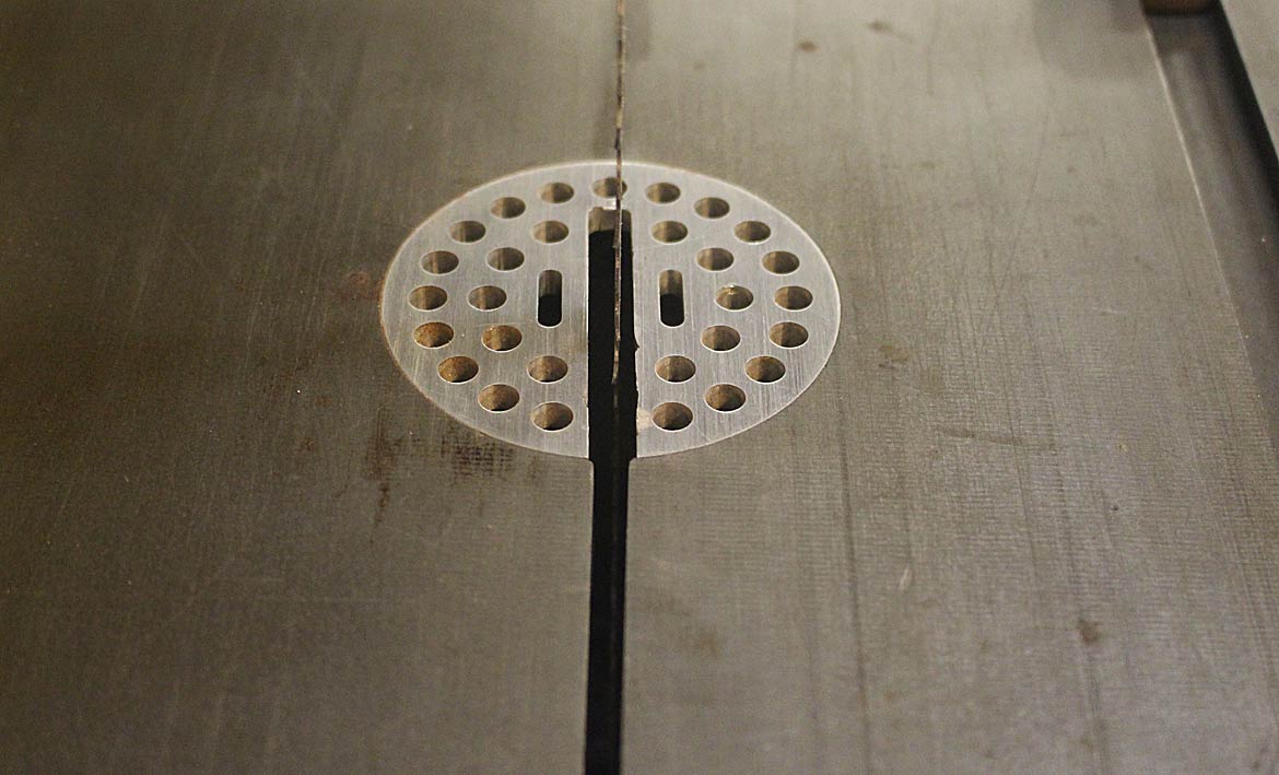

Matt, here are some modifications/accessories to consider for the N4400. I have had mine about 10 years. It is a single phase, 4 h.p. motor running on a 20 amp circuit.
1. This is a CNC-made aluminium insert, replacing the plastic one which warps.
2. Another CNC-made item, a mitre gauge ..
The N4400 has an atypical slot - it is much shallower than all others. I found that I could use a cheap F-clamp blade with a minor amount of side sanding ...

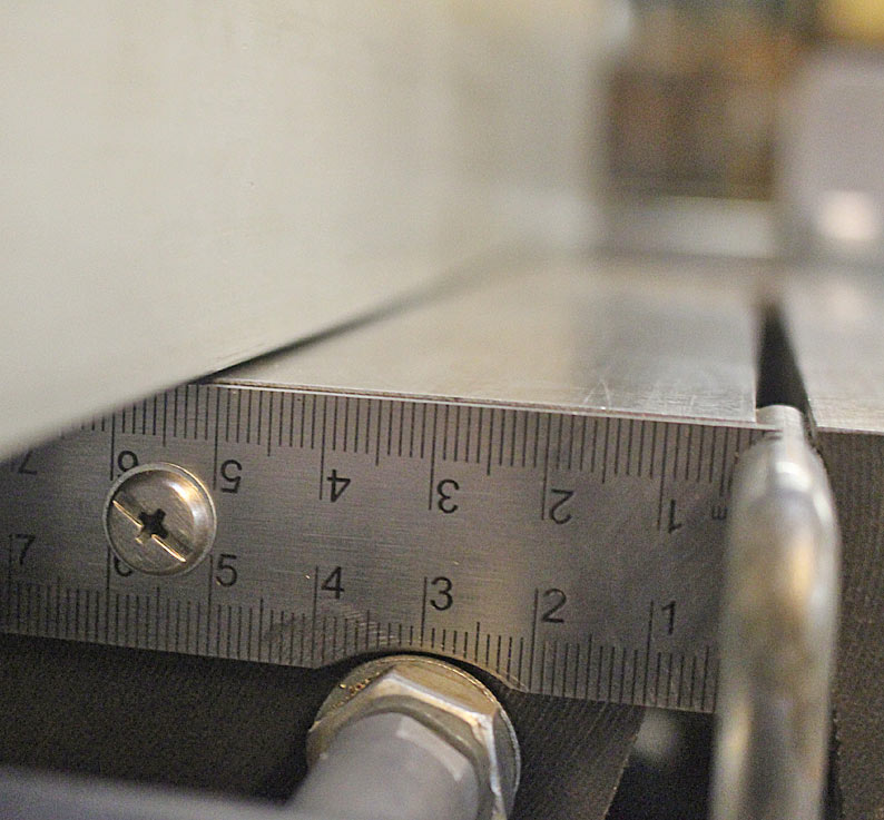

3. I attached a steel ruler to set the fence ...

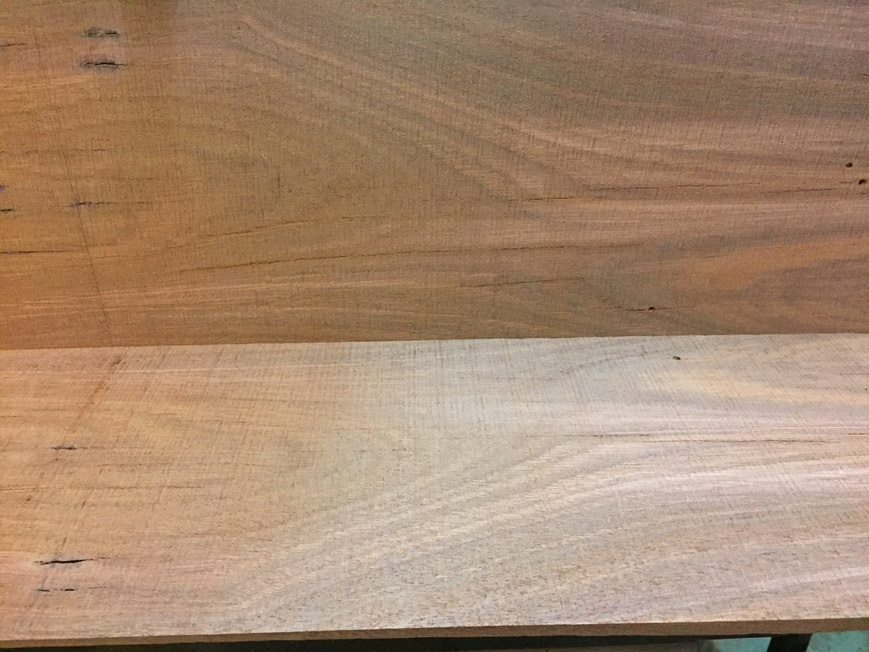

This is a Jarrah board re-sawn using a 1" Lenox Woodmaster CT blade ...

Matt - are the rips consistent in width? It is hard to tell from the pictures, but the little ripples are likely caused by the alternating set of the teeth. You need to use a blade without set to get smoother rips. You will likely not achieve a glue-ready rip with a bandsaw, though. Close, but it will not be perfect. I pass over the jointer will likely be needed regardless of blade.
Nice saw, BTW!

Matt, it is difficult to judge from the small photo and small edge you posted, but the resaw looks reasonable. Technique comes into this as well - if you push the work piece too fast, the gullets fill up with sawdust faster, and then they push it away from the fence and cause waviness. Try pushing slower, and tension a little higher.
I would not purchase a 10 tpi blade. Return it for 3 tpi. The 1" CT resaw blade is 1.3 tpi. More teeth with simply load up faster. With 10 tpi, you have to push the blade excruciatingly slowly.
Matt, with respect, you have minimal time on a bandsaw. Learn how to use one before rushing off to buy new blades. Read my earlier comments about resaw fences. There is as much technique in all this as equipment.
As ScotF noted, a blade with less set will give you a smoother cut surface. Consider the Wood Slicer® Resaw Bandsaw Blades from Highland Woodworking. They are available in 1/2" & 3/4" widths. The blade band thickness is .022" and it leaves a kerf that's .032". So the tooth set is only .005" per side. No cutting curves with these guys, resawing only.
https://www.highlandwoodworking.com/woodslicer34resawbandsawblades105to166.aspx
Also stick with a 3-4 tooth blade because as Derek said you need the tooth spacing (gullet) to be large so it can remove the material efficiently from the cut.  Just like a table saw, you're ripping the material so the tooth count needs to be low.
I've resawn a bunch of aromatic cedar which has a Janka hardness equivalent to maple or cherry. This was all done on a Delta 14" bandsaw which isn't exactly a power house.  [smile]
