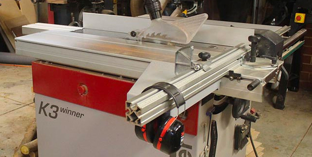

Derek,
As one of the most talented hand tool woodworkers I've seen on this and other forums I'm surprised to see such nice machinery in your shop. Mind sharing what else you have? Is it just those 3 or do you have all the usual suspects?
You are very kind. With regard to machines, I have upgraded most over the past 10 years, but really it should be seen as a 30-year period of development. I use machines fir the grunt work, and prefer handtools for all joinery, advanced shaping and finishing.
I also have a shortbed Hammer K3 slider, a Nova Saturn lathe, a small 9x6 belt sander, as well as a router table built into the K3, and a host of routers, etc, etc.
