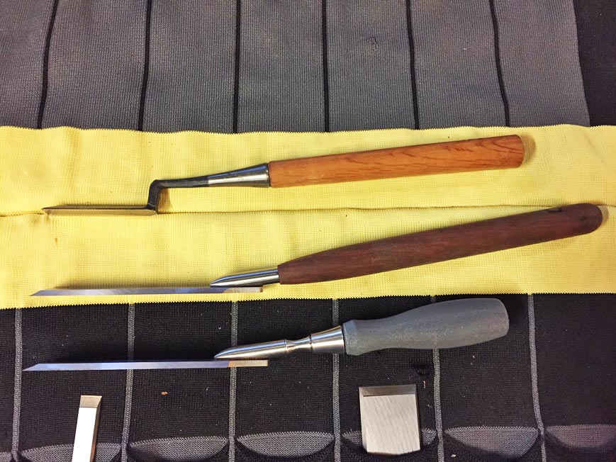

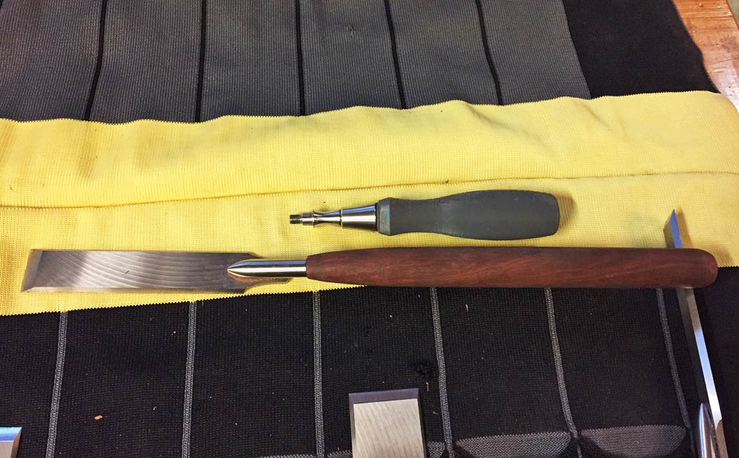

I have been using this prototype set since 2016 ...
The handle is printed but very functional. The blades are the same as those that went into production. They came flat ... flat ... flat. Which is important since that is how they are used.
Harvey, the screw connection is tight and does not loosen.
Are they useful? Very, in the right circumstance.
Are they necessary? No, one can use a chisel bevel down, or every a thick plane blade.
Should you get them? I don't know about getting a whole lot of cranked chisels. I have always had a couple of flat ones and a few cranked gouges. They get used, but they are specialist chisels, so not used very often. I think that the whole point of the Veritas offering is that you get one handle and a couple of blades. It is more cost-effective as well as a space saving.
One of the additions I made to this set was to add a long handle ... ala a Japanese slick (very easy to do as all you need is to recess a thread, which is a standard size). I found that I liked the extra length for control, plus it gave a little more clearance when pushing.
Here is a comparison with a Japanese cranked neck chisel ...

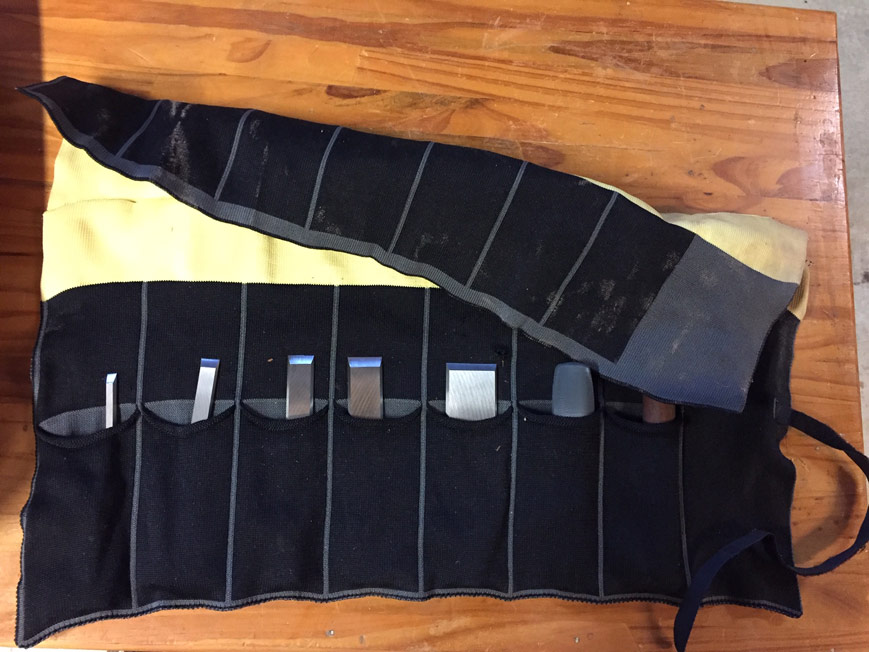

They helpfully include a screw and fender washer that makes it easy to hang the blades, so I guess I don't have need now for the roll that was included with the set, in case anyone wants it.
« Last Edit: August 22, 2019, 11:15 AM by ear3 »
Kapex KS 120 w/UG Cart and Extensions • CXS Set • T18+3 w/Centrotec Installer's Set • PDC 18/4 • TS 75 • TSC 55 • HKC 55 w/250, 420 and 670 FSK rails • Carvex 420 w/Accessory Kit • Domino 500 Set • Domino 700 XL • OF 2200 w/Base Accessory Kit • OF 1400 • OF 1010 • MFK 700 EQ Set • LR 32 • MFS 400 w/2000, 1000, and 700 extensions • Rotex 90 • Rotex 150 • LS 130 • ETS-EC 150/5 • ETS-EC 150/3 • Pro 5 LTD • RTS 400 • RAS 115.04 • RS 2 • HL 850 • Vecturo OS 400 • AGC 18-115 • CT 26 w/BT module • CT Sys w/Long-Life Bag • MFT/3
