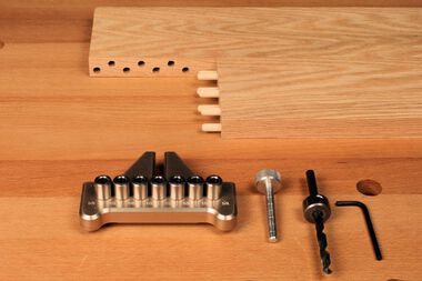

I don’t use the Domino system, but when I was building a door in 1-1/2 thick poplar, I used 1/2” x 2” dowels.  I staggered the placement.  That allowed the dowels to maintain a reasonable distance from each other and from the edge of the stock.
I don’t know if staggering is a reasonable strategy for dominoes, but it worked out well for the dowels.
Staggering allowed me to use more dowels than a single line would have and placed them off the center for greater stability.
Jessem shows that strategy in one of their videos.
